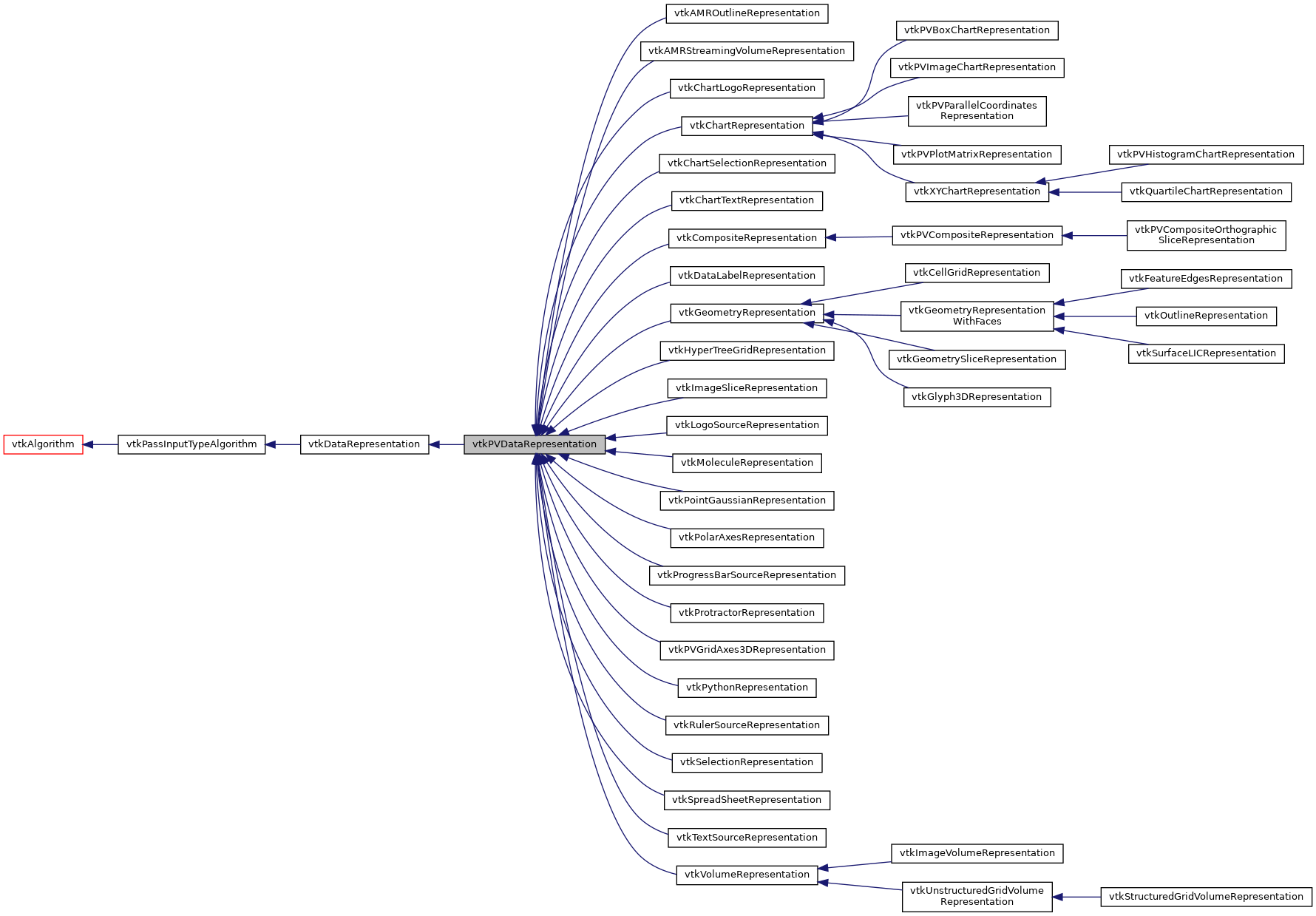

Inheritance diagram for vtkPVDataRepresentation:

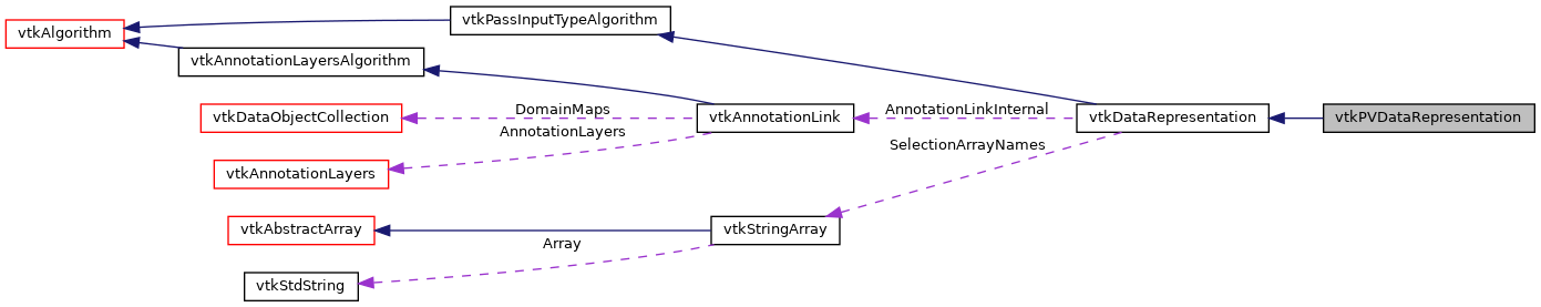

Collaboration diagram for vtkPVDataRepresentation:
