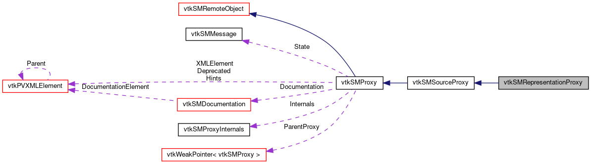

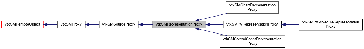

Proxy for a representations.
vtkSMRepresentationProxy is a vtkSMSourceProxy subclass that is designed to be used either directly or as a superclass for "data" representations i.e. representation that have an input (as against proxies for annotations such as 3D widgets).
Special handling of `MarkDirty`
vtkSMProxy::MarkDirty is a mechanism that ParaView uses to know on the client side (i.e. in the server-manager layer) when a pipeline on the server side is "dirty" or has potential to execute on an update causing things like data information to be invalidated. Simply speaking, when a property on a vtkSMProxy is modified and pushed (using vtkSMProxy::UpdateVTKObjects or vtkSMProxy::UpdateProperty), it calls this->MarkDirty(this). vtkSMProxy::MarkDirty invokes vtkSMProxy::MarkConsumersAsDirty which results in any consumers of this dirtied proxy also getting the notification. Consumers (and conversely producers) are setup via ProxyProperty and InputProperty connections. For standard data processing pipelines, this mechanism works quite well. Consider a filter proxy, say Clip, which has an input set via a InputProperty and a implicit function set via a ProxyProperty. If either the input or the implicit function is modified, it is reasonable to expect the Clip filter to re-execute on an UpdatePipeline call. Whether the call will truly cause the VTK pipeline (server side) to execute is not that important. The pipeline may not re-execute and that's not a big deal.
Things get a little complicated for representations, however. Data representations don't necessary have valid input connections on all processes where their VTK objects are present (note, representations create VTK objects on all process while data input is only available on the data server nodes). As a result representations have to be explicitly told to re-execute following upstream changes since they cannot rely on their VTK-level upstream. Re-executing a representation means regenerating the geometry or data artifacts for rendering, redelivering them to the rendering nodes, etc. It can also mean cleaning up any caches the representation built for flip-book animation support. In other words, re-executing a representation is non-trivial task. Thus, we want do it only when absolutely needed.
The explicit pipeline update is often referred to as "update suppression" and handled by vtkPVDataRepresentation and vtkPVDataRepresentationPipeline. In short, calling Update on vtkPVDataRepresentation has no effect unless vtkPVDataRepresentation::MarkModified was explicitly called at some point since the last Update.
To explicitly call vtkPVDataRepresentation::MarkModified for only those cases where the representation must be re-executed, we follow the following strategy.
- vtkPVDataRepresentation subclasses explicitly call
this->MarkModified when a public API that invalidates the data pipeline is invoked.
- vtkSMRepresentationProxy overrides
vtkSMProxy::MarkDirtyFromProducer to call MarkModified on the VTK object if the producer was connected to the representation via a InputProperty and not a ProxyProperty. The assumption is that InputProperty connections typically imply pipeline connections while ProxyProperty connections are other supporting VTK objects e.g. LUT.
Definition at line 88 of file vtkSMRepresentationProxy.h.
