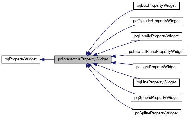

pqInteractivePropertyWidget is an abstract pqPropertyWidget subclass designed to serve as the superclass for all pqPropertyWidget types that have interactive widget (also called 3D Widgets) associated with them.
#include <pqInteractivePropertyWidget.h>
pqInteractivePropertyWidget is intended to provide a Qt widget (along with an interactive widget in the active view) for controlling properties on the proxy identified by a vtkSMPropertyGroup passed to the constructor. Subclasses are free to determine which interactive widget to create and how to setup the UI for it.
