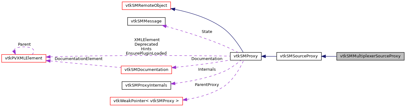

Inheritance diagram for vtkSMMultiplexerSourceProxy:
Collaboration diagram for vtkSMMultiplexerSourceProxy:
