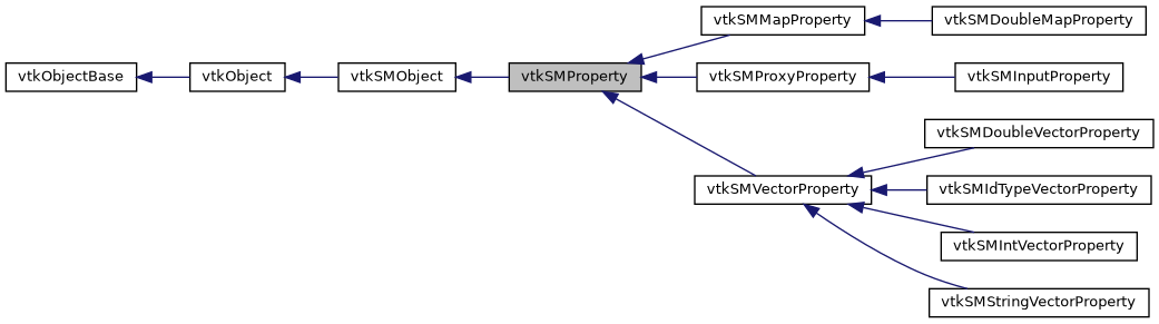

Inheritance diagram for vtkSMProperty:

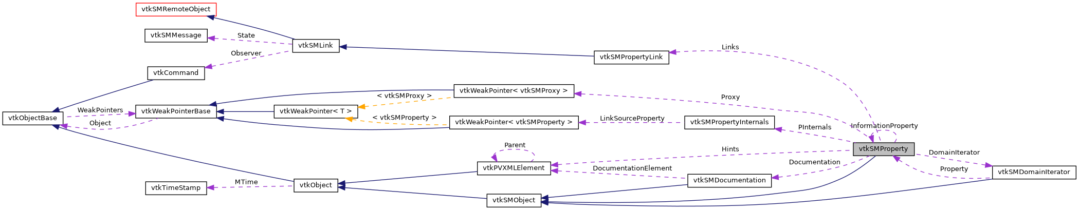

Collaboration diagram for vtkSMProperty:
