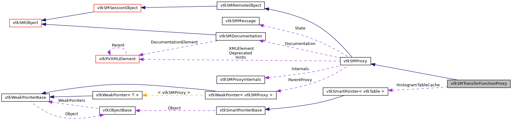

Collaboration diagram for vtkSMTransferFunctionProxy:
