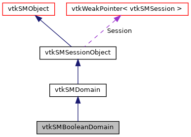

Inheritance diagram for vtkSMBooleanDomain:

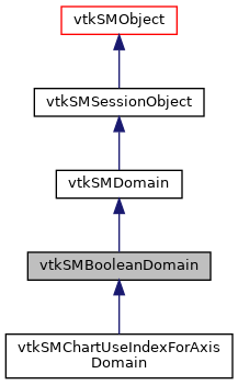

Collaboration diagram for vtkSMBooleanDomain:
