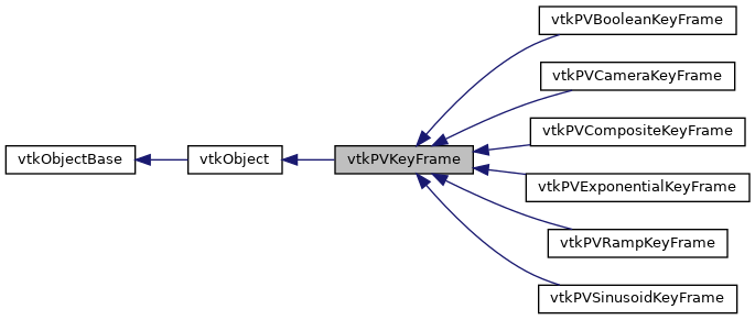

Inheritance diagram for vtkPVKeyFrame:

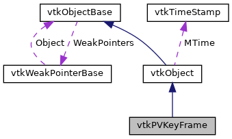

Collaboration diagram for vtkPVKeyFrame:
