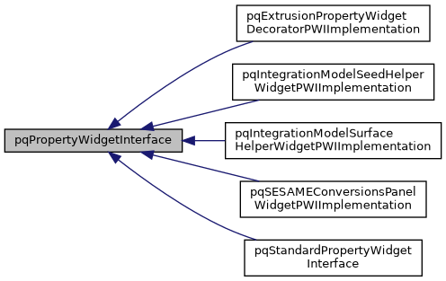

pqPropertyWidgetInterface is part of the ParaView Plugin infrastructure that enables support for plugins to add new pqPropertyWidget and pqPropertyWidgetDecorator types and make them available within the application. More...
