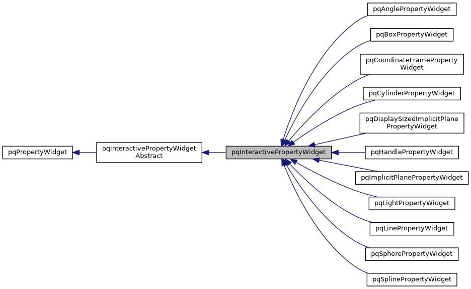

pqInteractivePropertyWidget is an abstract pqPropertyWidget subclass designed to serve as the superclass for all pqPropertyWidget types that have interactive widget (also called 3D Widgets) associated with them.
pqInteractivePropertyWidget is intended to provide a Qt widget (along with an interactive widget in the active view) for controlling properties on the proxy identified by a vtkSMPropertyGroup passed to the constructor. Subclasses are free to determine which interactive widget to create and how to setup the UI for it.
