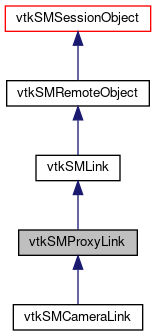

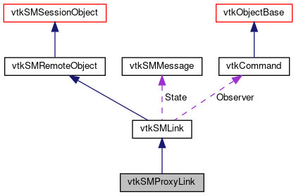

creates a link between two proxies.
When a link is created between proxy A->B, whenever any property on proxy A is modified, a property with the same name as the modified property (if any) on proxy B is also modified to be the same as the property on the proxy A. Similarly whenever proxy A->UpdateVTKObjects() is called, B->UpdateVTKObjects() is also fired.
