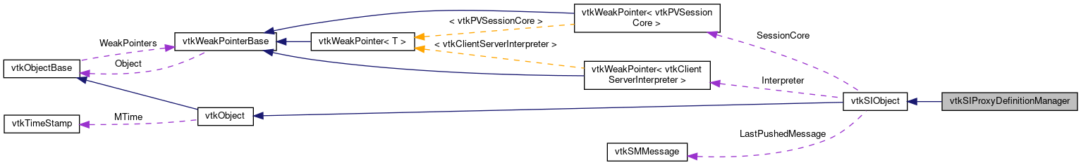

Protected Attributes inherited from vtkSIObject | |
| vtkWeakPointer< vtkClientServerInterpreter > | Interpreter |
| vtkWeakPointer< vtkPVSessionCore > | SessionCore |
| vtkSMMessage * | LastPushedMessage |
| vtkTypeUInt32 | GlobalID |
object responsible for managing XML proxies definitions
