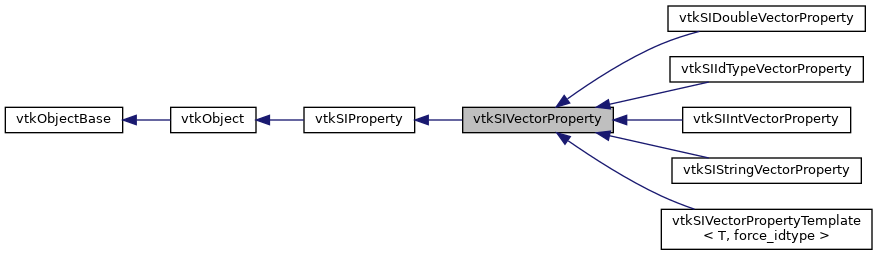

#include <vtkSIVectorProperty.h>

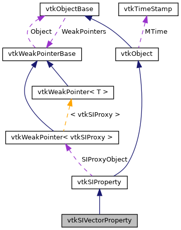

Inheritance diagram for vtkSIVectorProperty:
