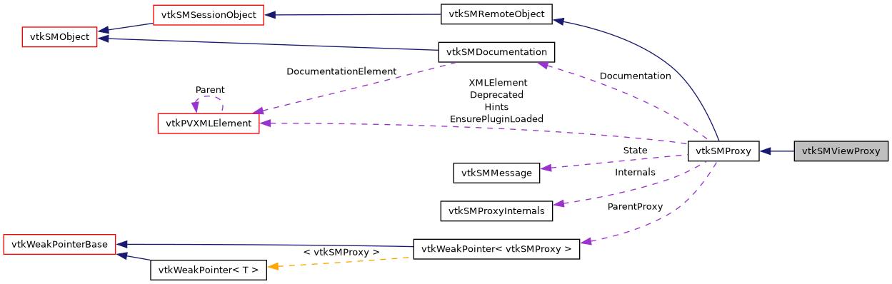

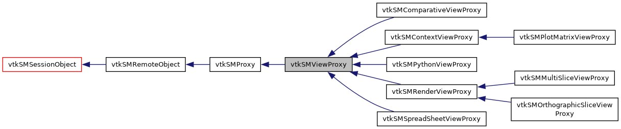

Inheritance diagram for vtkSMViewProxy:
Collaboration diagram for vtkSMViewProxy:
