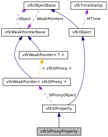

ServerSide Property use to set Object array as method argument.
Those object could be either SMProxy instance or their SIProxy instance or the VTK object managed by the SIProxy instance. The type of object is specified inside the XML definition of the property with the attribute argument_type=[VTK, SMProxy, SIProxy].
Definition at line 31 of file vtkSIProxyProperty.h.

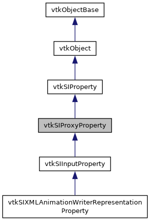

Reimplemented in vtkSIXMLAnimationWriterRepresentationProperty, and vtkSIInputProperty.
