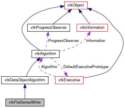

meta-writer for writing a file series using writers that are not time-aware.
vtkFileSeriesWriter is a meta-writer that enables writing a file series using writers that are not time-aware.
Definition at line 31 of file vtkFileSeriesWriter.h.
