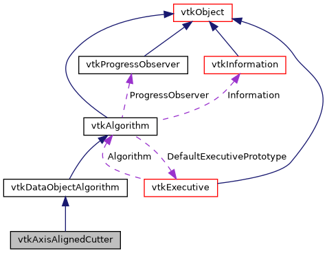

Collaboration diagram for vtkAxisAlignedCutter:
