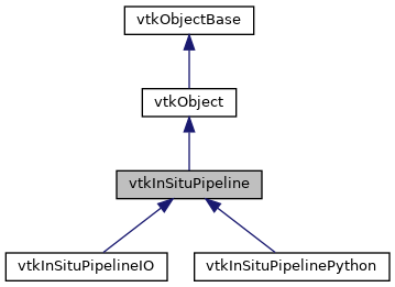

vtkInSituPipeline Class Referenceabstract
abstract base class for all in situ pipelines. More...
#include <vtkInSituPipeline.h>
Inheritance diagram for vtkInSituPipeline:
Collaboration diagram for vtkInSituPipeline:
vtkInSituPipeline is an abstract base-class for all in situ analysis pipelines.
A pipeline has three stages: Initialize, Execute and Finalize.
Initialize is called exactly once before the first call to Execute. If Initialize returns false, the initialization is deemed failed and pipeline is skipped for rest of the execution i.e. either Execute nor Finalize will be called.
Execute is called on each cycle. If the method returns false, then the execution is deemed failed and the Execute method will not be called in subsequent cycles.
If Initialize succeeded, then Finalize is called as the end of the simulation execution. Finalize is called even if Execute returned failure. However, it will not be called if Initialize returned failure too.
