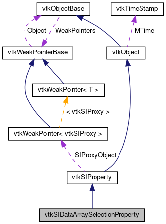

supports API using vtkDataArraySelection.
vtkSIDataArraySelectionProperty can be used to get/set array selection status parameters on a VTK object using vtkDataArraySelection. Readers typically offer API to get information about data array available as well as enable/disable arrays to read using a vtkDataArraySelection instance e.g. vtkXMLReader::GetPointDataArraySelection. This si-property can be used on vtkSMStringVectorProperty instances that use such an API on the reader to both get array selection status as well as set them.
This offers a convenient replacement for vtkSIArraySelectionProperty which requires a quirky API on the VTK class to get/set similar information and is recommended over vtkSIArraySelectionProperty in new code.
To use vtkSIDataArraySelectionProperty, simply add this as the si_class on the properties for getting and setting array selection with command set to the method name that returns a mutable vtkDataArraySelection instance.
