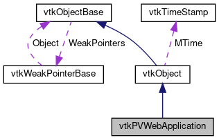

Collaboration diagram for vtkPVWebApplication:
