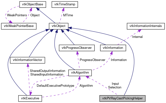

helper class that used selection and ray casting to find the intersection point between the user picking point and the concreate cell underneath.
| void | SetInput (vtkAlgorithm *) |
| | Set input on which the selection apply. More...
| void | SetSelection (vtkAlgorithm *) |
| | Set the selection that extract the cell that intersect the ray. More...
| void | ComputeIntersection () |
| | Compute the intersection. More...
| virtual double * | GetIntersection () |
| virtual void | GetIntersection (double &, double &, double &) |
| virtual void | GetIntersection (double [3]) |
| virtual void | SetPointA (double, double, double) |
| | Set the point 1 that compose the ray. More...
| virtual void | SetPointA (double [3]) |
| virtual double * | GetPointA () |
| virtual void | GetPointA (double &, double &, double &) |
| virtual void | GetPointA (double [3]) |
| virtual void | SetPointB (double, double, double) |
| | Set the point 2 that compose the ray. More...
| virtual void | SetPointB (double [3]) |
| virtual double * | GetPointB () |
| virtual void | GetPointB (double &, double &, double &) |
| virtual void | GetPointB (double [3]) |
| virtual void | SetSnapOnMeshPoint (bool) |
| | Set the flag to use directly selected points on mesh as intersection. More...
| virtual bool | GetSnapOnMeshPoint () |
Definition at line 30 of file vtkPVRayCastPickingHelper.h.
