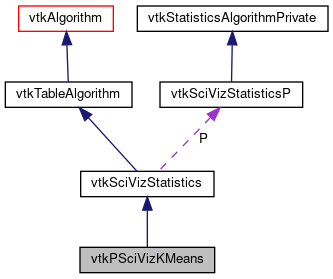

Find k cluster centers and/or assess the closest center and distance to it for each datum.
This filter either computes a statistical model of a dataset or takes such a model as its second input. Then, the model (however it is obtained) may optionally be used to assess the input dataset.
This filter iteratively computes the center of k clusters in a space whose coordinates are specified by the arrays you select. The clusters are chosen as local minima of the sum of square Euclidean distances from each point to its nearest cluster center. The model is then a set of cluster centers. Data is assessed by assigning a cluster center and distance to the cluster to each point in the input data set.
Definition at line 40 of file vtkPSciVizKMeans.h.
