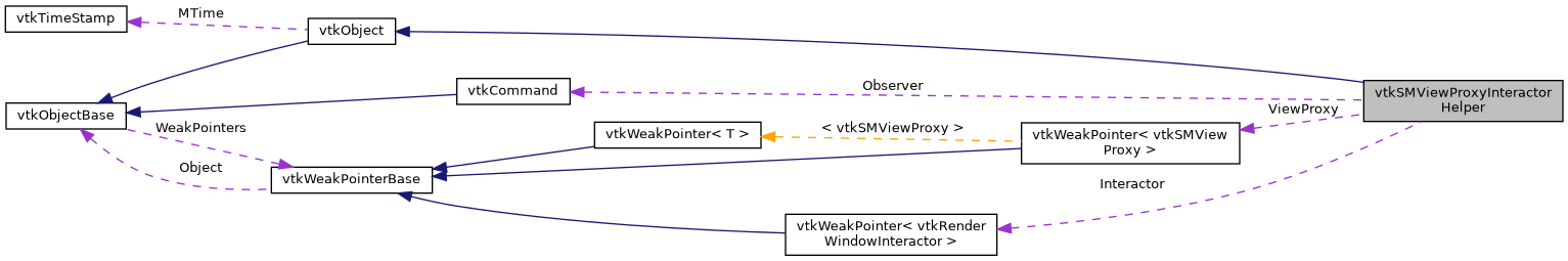

Inheritance diagram for vtkSMViewProxyInteractorHelper:
Collaboration diagram for vtkSMViewProxyInteractorHelper:
