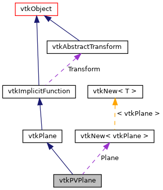

Inheritance diagram for vtkPVPlane:
Collaboration diagram for vtkPVPlane:
