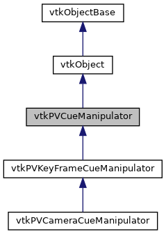

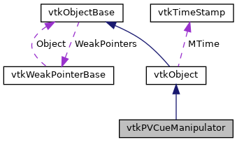

abstract proxy for manipulators used in animation.
An animation cue proxy delegates the operation of modifying the property on the proxy being animated to a Manipulator. An example of a manipulator is a vtkPVKeyFrameCueManipulator. Subclasses must override UpdateValue to perform the actual property manipulation. Just like all proxies involved in Animation, this is a client side proxy, with no VTK objects created on the server. A manipulator fires two kinds of events:

Reimplemented in vtkPVKeyFrameCueManipulator, and vtkPVCameraCueManipulator.
