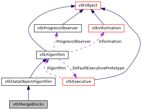

Collaboration diagram for vtkMergeBlocks:
