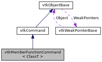

Inheritance diagram for vtkMemberFunctionCommand< ClassT >:
Collaboration diagram for vtkMemberFunctionCommand< ClassT >:
