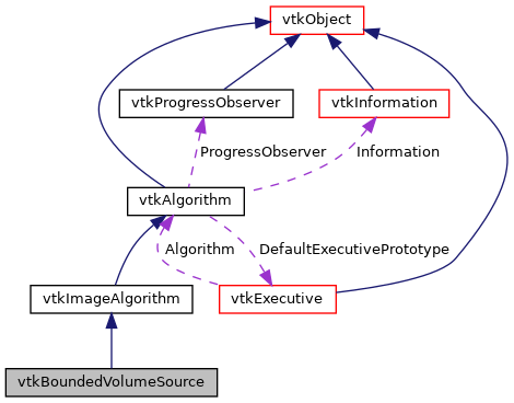

Collaboration diagram for vtkBoundedVolumeSource:
