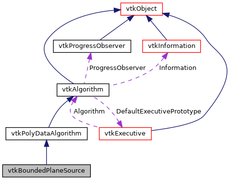

Collaboration diagram for vtkBoundedPlaneSource:
