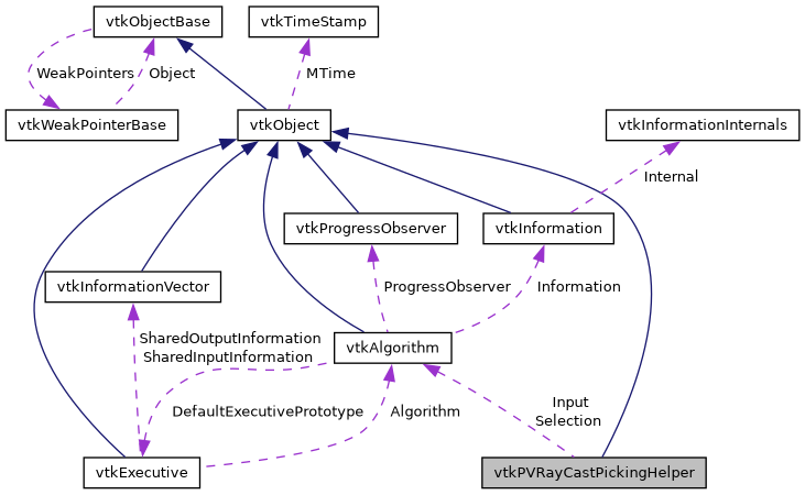

helper class that used selection and ray casting to find the intersection point between the user picking point and the concreate cell underneath.
Definition at line 21 of file vtkPVRayCastPickingHelper.h.
