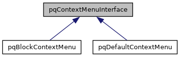

Inheritance diagram for pqContextMenuInterface:
