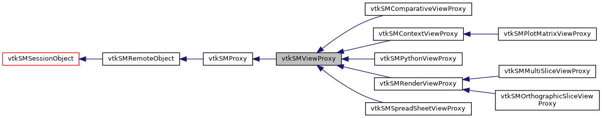

Inheritance diagram for vtkSMViewProxy:

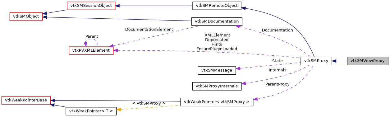

Collaboration diagram for vtkSMViewProxy:
