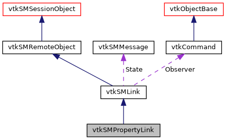

Inheritance diagram for vtkSMPropertyLink:
Collaboration diagram for vtkSMPropertyLink:
