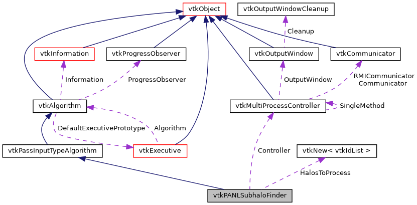

Collaboration diagram for vtkPANLSubhaloFinder:
