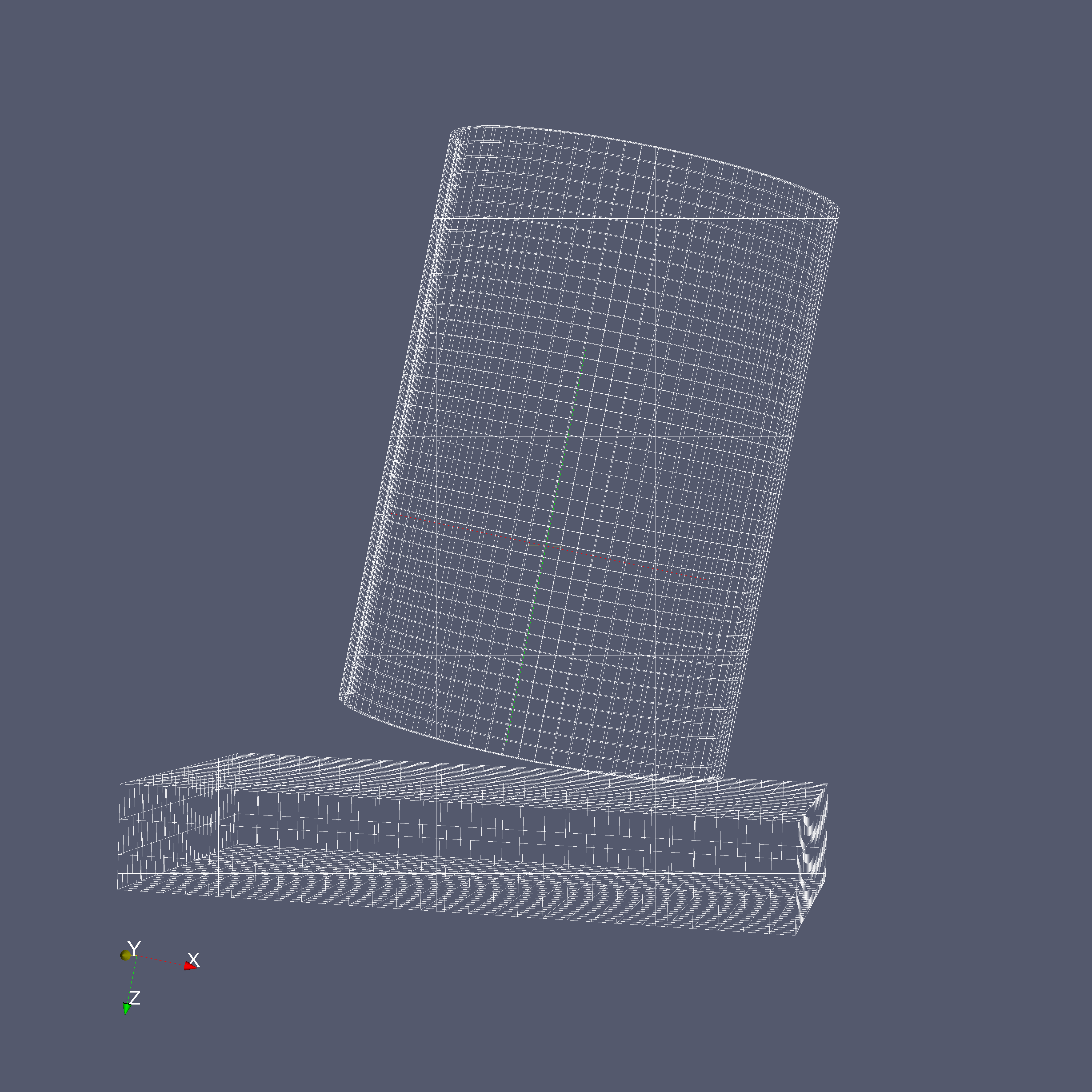

| Description | ParaView trunk. Local ParaView. Open can.exo. Rotate so you can see the can. Wireframe. File/ Save Screenshot/ 4096X4096 - OK. Save as .jpg (any output type fails). Open up the output file. Notice the additional lines. I am marking this important, since we have no way to create large wire frame images. | ||||||||

(0013912) Ken Moreland (manager) 2008-10-20 17:20 |
It looks right to me. Are you sure you are not confusing the wires from the front and back surfaces of the thin can? |
(0013913) Alan Scott (manager) 2008-10-20 17:23 |
Check the attached .png. Be sure to full screen it - otherwise there are aliasing artifacts. |
(0013914) Alan Scott (manager) 2008-10-20 17:24 |
Oh, forgot - any output picture file type shows this error. My description above is slightly unclear. For instance, I attached a .png as an example of the problem. |

(0013921) Utkarsh Ayachit (administrator) 2008-10-23 13:16 |
The issue may have something to do with OpenGL implementation. A long long time ago I had run into this with Mesa (I think). We are rendering wireframe by rendering polygons with FILL_MODE set to (GL_LINES). In some implementations of OpenGL, in this case, if a polygon is clipped by the viewport then OpenGL renders a false polygon edge at the viewport boundary. |
(0023661) Alan Scott (manager) 2010-12-01 21:42 |
