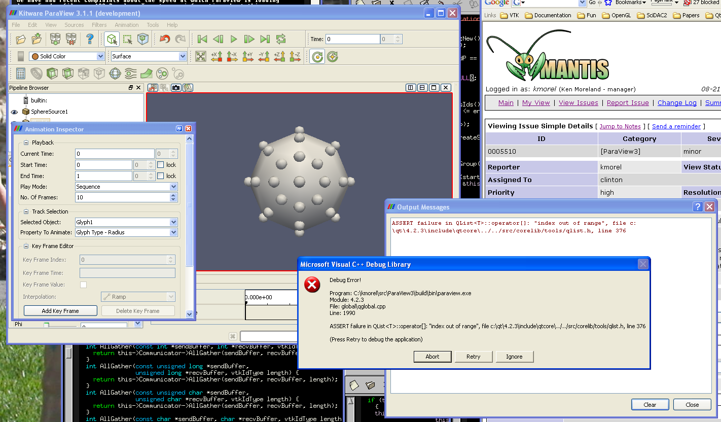

(0008541) Ken Moreland (manager) 2007-08-21 12:18 |
Now when I try to add keyframes for the glyph radius, ParaView crashes. There is an assert failure for an overrun array index in Qt. I have attached a screenshot of the problem. |
(0008543) Clinton Stimpson (developer) 2007-08-21 12:35 |
/cvsroot/ParaView3/ParaView3/Qt/Components/pqAnimationViewWidget.cxx,v <-- pqAnimationViewWidget.cxx new revision: 1.24; previous revision: 1.23 Fixed out of range. |
