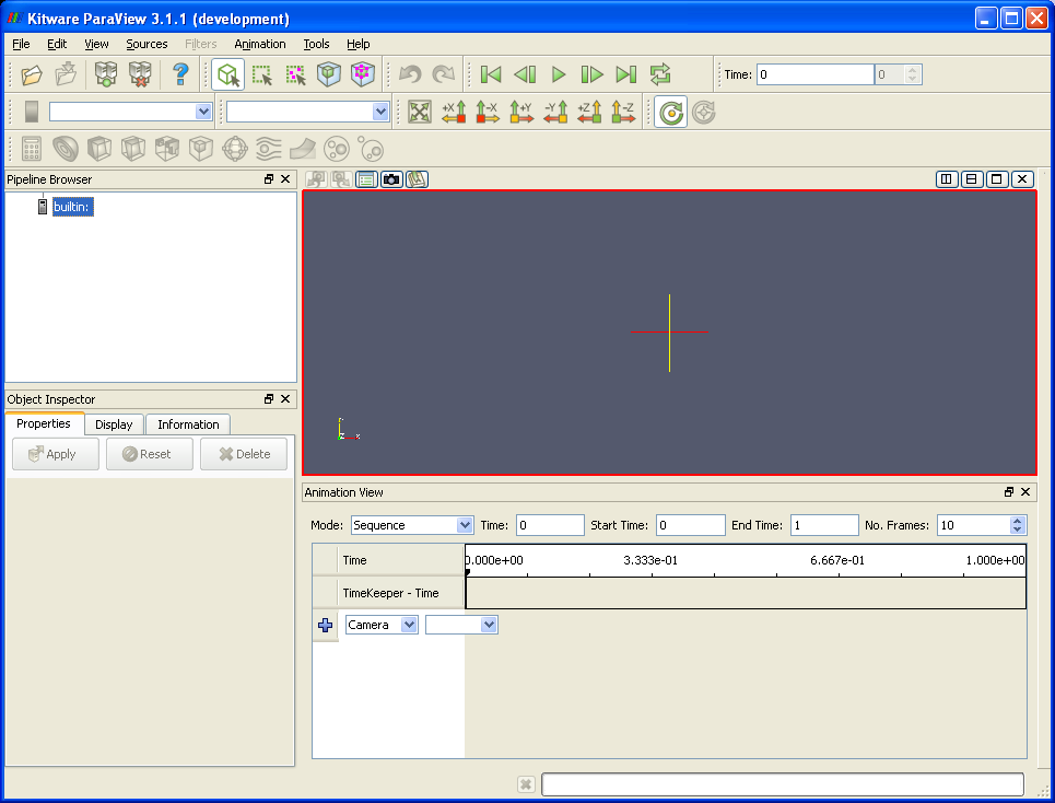

(0008689) Ken Moreland (manager) 2007-08-27 18:39 |
I like the implementation. Very clever. However, on my Windows box part of the animation view has the wrong background color. See the attached image. |
(0008710) Clinton Stimpson (developer) 2007-08-28 12:53 |
/cvsroot/ParaView3/ParaView3/Qt/Widgets/pqAnimationWidget.cxx,v <-- pqAnimationWidget.cxx new revision: 1.14; previous revision: 1.13 |
(0008785) Ken Moreland (manager) 2007-08-30 15:44 |
I am still seeing this problem. Is there something special I have to do (clean my build or something) in order to see the fix? |
(0008843) Clinton Stimpson (developer) 2007-09-05 14:59 |
I think I got it. Don't have XP on hand to try. /cvsroot/ParaView3/ParaView3/Qt/Widgets/pqAnimationWidget.cxx,v <-- pqAnimationWidget.cxx new revision: 1.16; previous revision: 1.15 |
