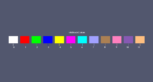

| Description | Please change the default vtkBlockColors to the following 12 colors. These colors will appear in the Color Editor/ Annotations section. 255, 0, 0 0, 255, 0 0, 0, 255 255, 255, 0 255, 0, 255 0, 255, 255 77, 175, 74 160, 160, 255 170, 128, 85 255, 128, 192 134, 90, 179 255, 192, 128 | ||||||||

I closed the other, somewhat unrelated bug. Using this one to change the KAAMS Annotation colors as per our conversation. * Delete color 6 (row 7), which is a dark green (76, 176, 74) * Move all colors above this deleted color down one. * Please add white, 255,255,255 as color 0. |
(0034893) Cory Quammen (developer) 2015-08-05 15:14 |
Alan, Is this the order you had in mind? Thanks, Cory |

Yes, that is the order we wanted. We are trying to make color 0 match other datasets, and get rid of the color that is closest to others. If you have other ideas, I am all ears! |
(0034905) Cory Quammen (developer) 2015-08-06 10:01 |
Merge request posted: https://gitlab.kitware.com/paraview/paraview/merge_requests/276 [^] commit f52f9e047aa7ca9fb27fee6c8bd36a440511411a Author: Cory Quammen <cory.quammen@kitware.com> Date: Wed Aug 5 15:45:50 2015 -0400 15489: Reordered colors in KAAMS colormap White is the now the first. Removed dark green. Updated baselines to use the new colors. |
