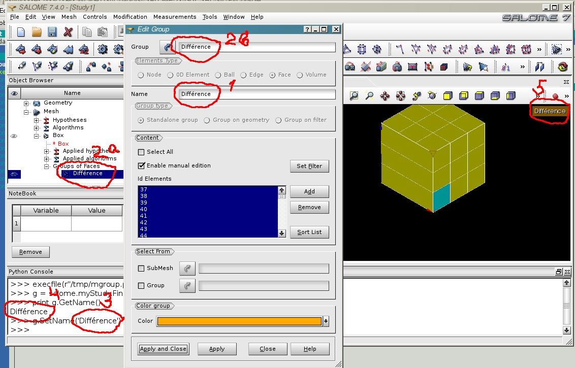

Dear Joachim, Thank you for explanations. Indeed, it seems that passing 'Diff\xe9rence' to Python might be not correct, if we want Unicode strings to be shown. It seems to be more correct to pass "Différence" or "Diff\xC3\xA9rence", and naturally "Différence" is more preferable way. However, there are still problems with processing Unicode strings in ParaView. I think, when you say "because of the Qt layer, this does not work in the GUI" - it is not quite correct. Indeed, as all application components like Qt, Python and VTK declare support of Unicode strings, there potentially should not be problems with interchanging data between these components, provided that all is implemented in a coherent way. For example, please take a look at the snapshot from SALOME application (salome.png). In SALOME we pass data between different application components, including: - From Qt widget (GUI side) to server process via CORBA bus : here we use QString::toUtf8() to pass data as CORBA::String (i.e. char*) [case 1 on the image] - From server process back to Qt widget (GUI side) via CORBA bus : here we use QString::fromUtf8() to ensure data is properly converted from char* and shown in GUI [cases 2a and 2b on the image] - From Qt widget to embedded Python interpreter : via QString::toUtf8() [case 3 on the image] - From embedded Python interpreter back to GUI (Python's feedback) : via QString::fromUtf8() [case 4 on the image] - From Qt widget to VTK presentation : QString::toUtf8() [case 5 on the image] As demonstrated by this example, in all cases unicode string data is shown properly. It is OK when we use either "Différence" or "Diff\xC3\xA9rence" in a Python script. However, in ParaView it's no OK - with both "Différence" or "Diff\xC3\xA9rence") used in a Python script we see good text in VTK viewer but bad one in Qt widget (see paraview.png). It seems that there is missing QString::fromUtf8() somewhere. An attempt to pass 'Différence' via "Properties" pane leads to a "vtkUnicodeString::from_utf8(): not a valid UTF-8 string" error. Missing QString::toUtf8()? Also, it's necessary to mention that the processing of a text in the viewer seems to depend on the way we do this. For instance, in SALOME, if we use vtkTextActor for displaying text label in a viewer, unicode text is shown correctly (as demonstrated by salome.png). However, if we use vtkActor2D with vtkTextMapper for the same purpose, the result is bad. Here is the corresponding code: // This is OK... myTextActor=vtkTextActor::New(); myTextActor->SetInput(qtstring.toUtf8().constData()); // This is KO... myTextMapper=vtkTextMapper::New(); myTextActor=vtkActor2D::New(); myTextActor->SetMapper(myTextMapper); myTextMapper->SetInput(qtstring.toUtf8().constData()); Regards, Vadim. |
(0032907) Joachim Pouderoux (developer) 2014-06-20 06:06 edited on: 2014-06-20 07:52 |
Thanks for your detailed answer. I have just pushed a fix for this issue but so far it just fixes the Qt=>Proxy problem. I still need to fix Proxy=>Qt. http://review.source.kitware.com/#/c/15866/ [^] Change Ia527552c: Fix pqStringVectorPropertyWidget to support utf8 strings. The problem is described in ticket 0014729. UTF8 chars were not correctly converted (toLatin1()) was used so TextSource for instance were not able to support accentuated chars. Change-Id: Ia527552c230351364541ddff2e9a527784bed976 |
