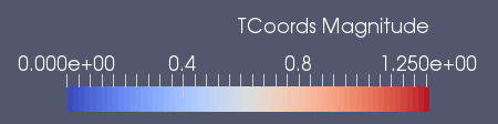

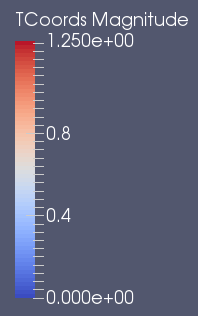

(0032820) Cory Quammen (developer) 2014-06-10 11:59 |
Alan, Please see the attached images for how the min/max labels will appear in the color legend. Is this what you were looking for? |
