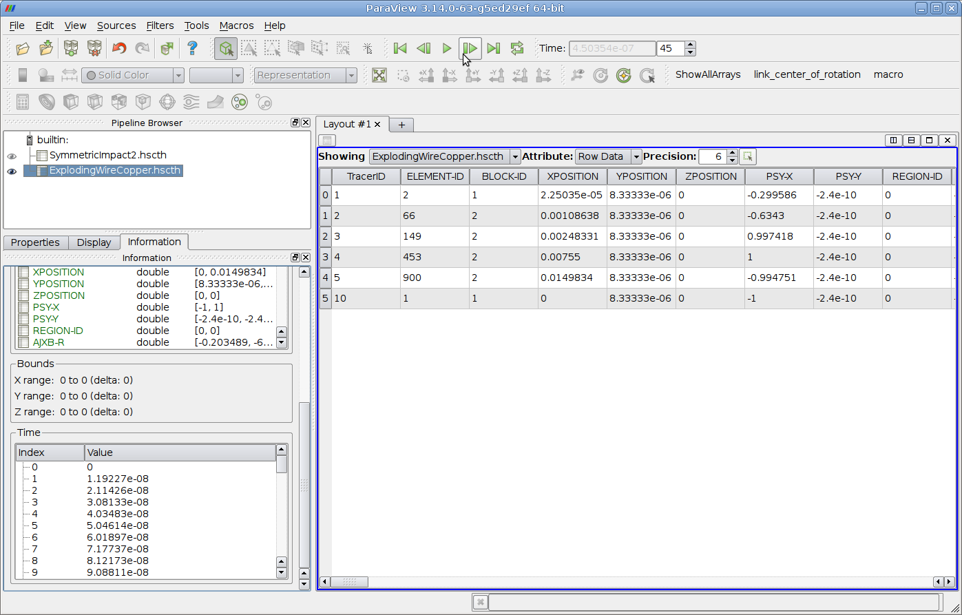

I could not reproduce this issue. I tried with SymmetricImapact3.hscth, SymmetricImapact2.hscth, ExplodingWireCopper.hscth and all have timesteps and the CSV values change as I go through timesteps. I've attached a couple of screenshots showing the information tab shown the detected timesteps. |
