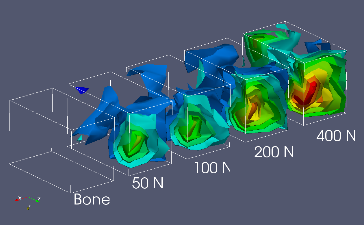

| Summary | 0012355: 2D text renders with missing parts of last letter | ||||||||
| Description | When making 2D text, part of the last character is not rendered, this is particularly bad when the first character is narrow and the last character is wide. In the attached image, see the "100 N" and "Bone" annotations. +===== System info ======+ Ubuntu 10.10 64 bit 2.6.35-30-generic 0000054-Ubuntu SMP Tue Jun 7 18:41:54 UTC 2011 x86_64 GNU/Linux ParaView 3.10.1 64bit (pre-compiled binary download) Qt Version 4.6.3 nVidia Graphics: G92 [GeForce GTS 240] | ||||||||

(0028345) Menno Deij (reporter) 2012-03-09 09:09 |
This should really be solved, see the screenshot I just made of the number 18. About 20% of the 8 character is wrapped around & rendered incorrectly. |

(0028570) Utkarsh Ayachit (administrator) 2012-05-03 16:20 |
commit 24da3fc7c6f50a8d563f2a17346e79e364d9f5a0 Author: Utkarsh Ayachit <utkarsh.ayachit@kitware.com> Date: Thu May 3 16:17:06 2012 -0400 BUG 0012898. Fixed occasional clipping of text. Text would get clipped for certain texts. The problem was that the texture coordinate computation did not consider +ve x-offsets for the rendered text. Fixed that. Change-Id: Iac85237b5349255341a735ceb37d57c4d23b6cc1 |
