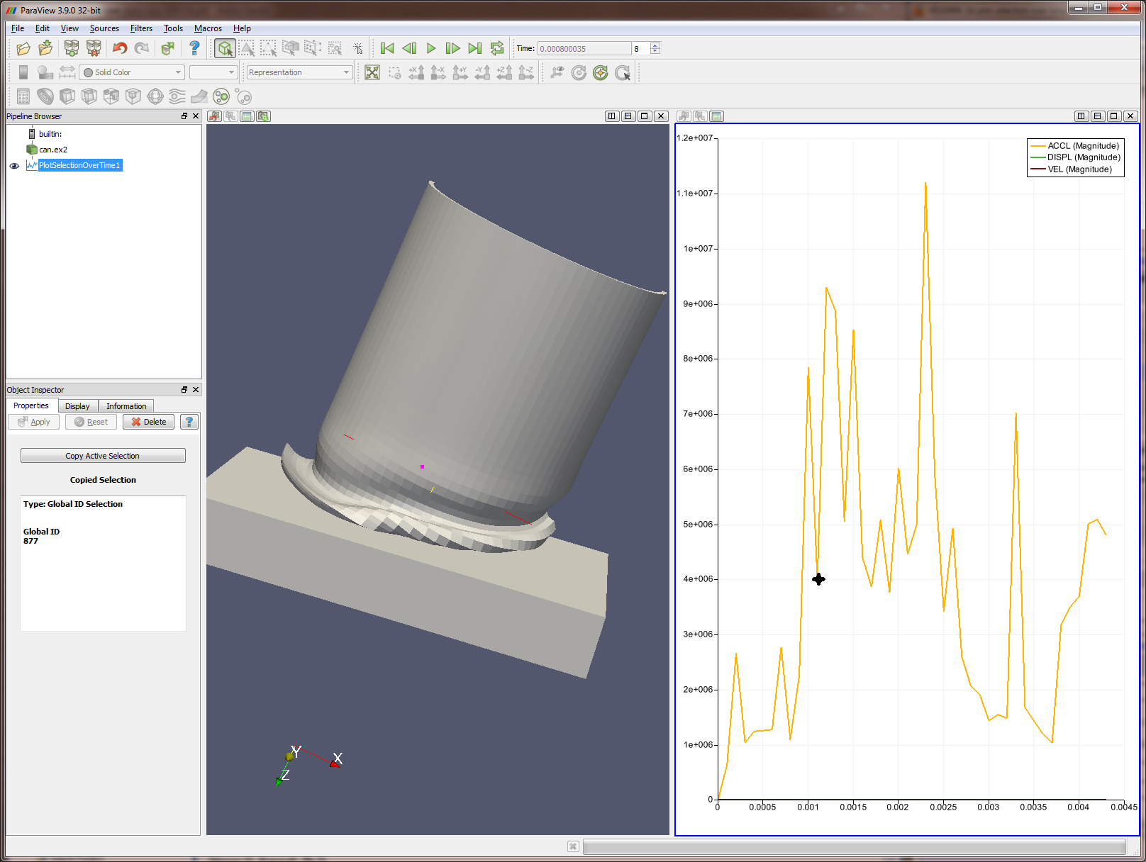

Description | A user has requested that 2d plots of selection over time, add the ability to put a current time mark in the 2d plot. If we are at time step 5, allow a mark at time step 5. Usecase is where a user wants a full screenshot of ParaView at a particular time step, 3d window along with the 2d time plot of a cell. | ||||||||

Nope, different feature. * What you state above is a text display of the current time. * What I am asking for is a mark, or cursor, or cross, or line, on the 2d plot itself that shows that time we are at. One is text based, the other is mark based. |

Please see the attached screenshot. Isn't that what you're looking for? Or am I misreading this altogether? Also note that it reflects the current time, so try going back/forth in using the VCR controller to see the marker more clearly. I used "Plot Selection Over Time" to generate the plot. |
(0026436) Alan Scott (manager) 2011-05-04 14:10 |
Yes, this is what I was looking for. It would be nice to allow this option to be toggled on and off, but lets wait until we have a request. Tested trunk, local server, Windows. |
