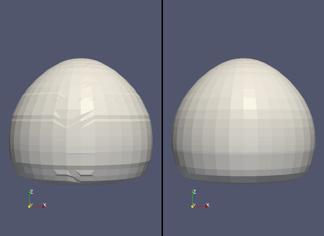

| Description | Clip by scalar is different, and significantly rougher, than contour. ParaView trunk, local server, XP Open disk_out_ref.exo, turn all variables on, apply. Clip, scalar, temp, 400, apply. Split horizontal, highlight disk_out_ref.exo in the pipeline browser. Contour, Temp, 400, apply. Link the two windows, then +Y (or +Z) Bug - these two images are not the same. Contour is much smoother, but clip by scalar is more useful. Please fix clip by scalar to use the same algorithm as contour. There is a dataset that we are trying to get to Kitware that shows this even better, but I wanted to get this going. The new dataset is called Whipple Shield. | ||||||||

(0015602) Ken Moreland (manager) 2009-03-09 10:41 |
This is actually a much more complicated request than it sounds like. |
(0020940) Alan Scott (manager) 2010-06-07 21:32 |
Fixed, right? |
(0021042) Alan Scott (manager) 2010-06-16 15:26 |
Tested local server, Windows, trunk. Looks fabulous. |
