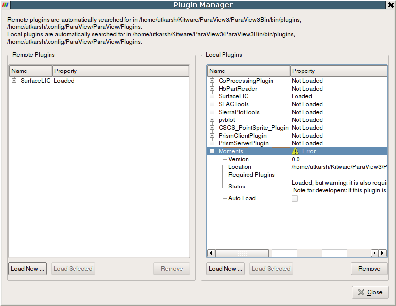

Oftentimes a plugin has both server-side as well as client-side components to it. For example, a plugin that adds a new filter and a property panel that goes with that filter. Such plugins need to be loaded both on the server as well as the client.
Generally, users don't have to worry whether a plugin is a server-side or client-side plugin. Simply load the plugin on the server as well as the client. ParaView will include relevant components from plugin on each of the processes.

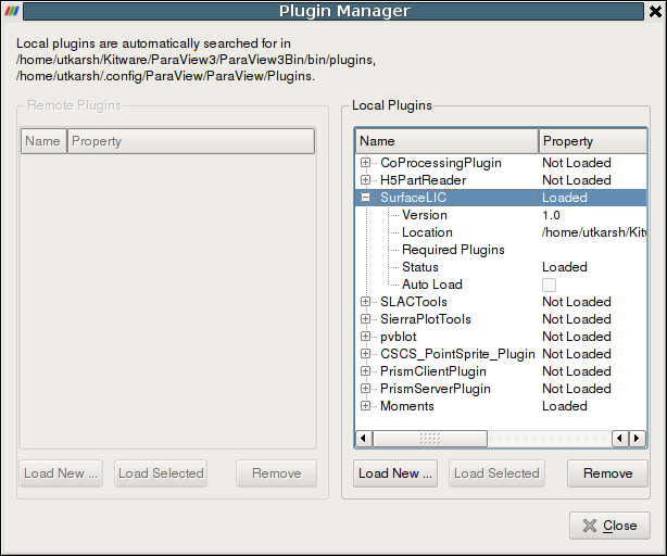

Plugin Manager)Plugin Manager accessible from the Tools | Manage Plugins/Extensions menu. The Plugin Manager has two sections for loading client plugins and server plugins (shown only when connected to a server). To load a plugin on the client and server side, simply browse to the plugin shared library. If the plugin is loaded successfully, it will appear in the list of loaded plugins. The Plugin Manager also lists the paths it searched to load plugins automatically.Plugin Manager remembers all loaded plugins across ParaView instances, so once a plugin is loaded once, it will appear in the future (unloaded).

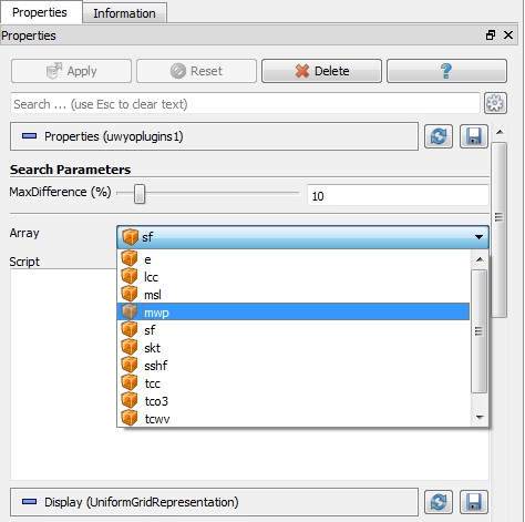

This creates a drop down list with 3 choices. The values associated with the choices may be specified.
This creates a list that lets you choose among the input arrays of the input of a ProgrammableFilter:
This will look like the following image:

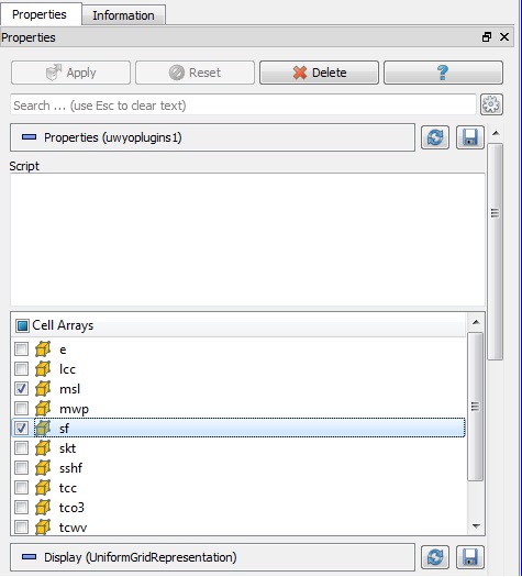

If you need to populate a list with values from a file and be able to select/deselect list entries (e.g., to pick which variables are loaded from the file), use a XML similar to this:
You can see an example in use in ParaView's core readers XML.
You may also do it in the following manner:
In which case the result will look like this:

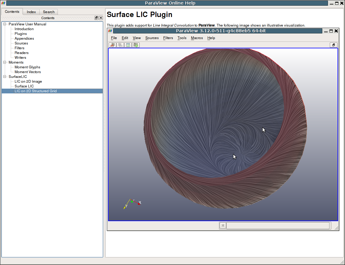

Developers can provide documentation for plugins that is shown in ParaView's Help window. There are two mechanisms for adding documentation from plugins.
paraview_add_plugin function or those attached to modules passed to its MODULES argument using paraview_add_server_manager_xmls are automatically parsed to process Documentation elements. HTML pages summarizing the proxy and properties are automatically generated. This ensures that when the user clicks "?" for a filter or source added via the plugin, the help window shows appropriate help pages.DOCUMENTATION_DIR argument to paraview_add_plugin to specify a directory containing HTML pages and images that gets added a the documentation for the plugin (in addition to the documentation generated using the SERVER_MANAGER_XML files. For example:This results in adding documentation to the ParaView Online Help when the plugin is loaded, as shown below.

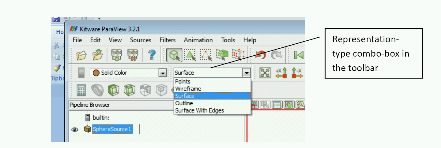

ParaView's 3D view the most commonly used view for showing polygonal or volumetric data. By default, ParaView provides representation-types for showing the dataset as surface, wireframe, points etc. It’s possible to add representations using plugins that extends this set of available representation types.
Before we start looking at how to write such a plugin, we need to gain some understanding of the 3D view and its representations. The 3D view uses 3 basic representation proxies for rendering all types of data:
UnstructuredGridRepresentation) – for vtkUnstructuredGrid or a composite dataset consisting of vtkUnstructuredGrid.UniformGridRepresentation) – for vtkImageData or a composite dataset consisting of vtkImageDataGeometryRepresentation) – for all other data types.Each of these representation proxies are basically composite representation proxies that use other representation proxies to do the actual rendering, e.g., GeometryRepresentation uses SurfaceRepresentation for rendering the data as wireframe, points, surface, and surface-with-edges and OutlineRepresentation for rendering an outline for the data. Subsequently, the 3 composite representation proxies provide a property named Representation which allows the user to pick the representation type he wants to see the data as. The composite representation proxy has logic to enable one of its internal representations based on the type chosen by the user.
These 3 composite representation types are fixed and cannot be changed by plugins. What plugins can do is add more internal representations to any of these 3 composite representations to support new representations types that the user can choose using the representation type combo box on the display tab or in the toolbar.
